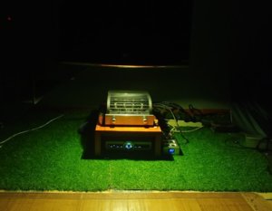

  11. quyennguyen
    quyennguyen Advanced Member
    1/9/16
    412
    849
    Hưng Yên
    tml3nr likes this.
  12. tinhdhmo
    tinhdhmo Advanced Member
    26/10/08
    1.914
    1.067
    Vâng, vậy là ổn rồi.
    quyennguyen likes this.
