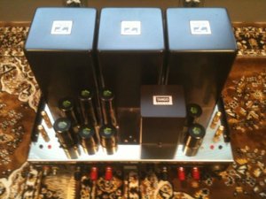

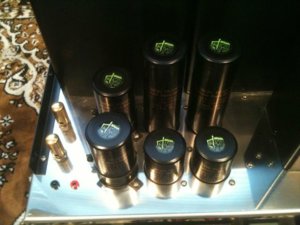

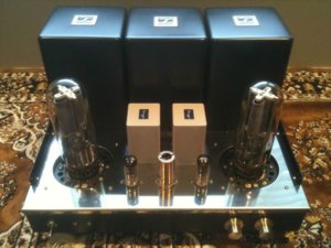

  24. MasterBody
    MasterBody Advanced Member
    4/5/10
    529
    19
    Hoàng Mai, Hà Nội
    TRAI MỚI LỚN (POW) TUYỂN VỢ...CỤ NÀO CÓ CON CHÁU GÁI (PRE) XINH TƯƠI TRẺ ĐẸP THÌ MỜI ZÔ.. :D
    Cháu nó được trang bị
    Black Gates:
    100+100/500V x 2 .
    100+100/350V x 2.
    47+47/500V x 4.
    100/50v x 2.
    Jensen:
    10000/63V x 4.
    0,22/1000V x 5.
    Mundorff TubeCap:
    30uF/600v x 3.
    Audio Note Tantallum resistors
    DACT - mono attenuator CT2-1 x 2 pcs.
    RCA - Cardas Ni .
    Wiring - FURUTECH Cooper.
