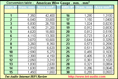

    AWG chỉ là cỡ dây to nhỏ đánh số theo chuẩn USA thôi bạn ạ.

    AWG (American wire gauge) A specification for non-ferrous (e.g., copper, aluminum, gold, silver, etc.) wire diameter. [Note, for example, that this means that 14 gauge galvanized steel wire & 14 gauge cooper wire have different diameters.] Also known as Brown and Sharp (B&S) wire gauge, after J.R. Brown who devised the system in 1857. The British standard is called SWG standing for Standard wire gauge, also called Imperial wire gauge.
    Nói chung là để nói lên tiết diện dây dẫn
    Tham khảo tính quy đổi:
    http://www.alphawire.com/pages/381.cfm
    http://www.alphawire.com/pages/382.cfm?partner=0&part=0
