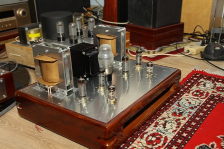

    Cả 2 bộ gông (làm thêm 1 bộ) , mặt trên và dưới ampli, mặt trước và sau. Tổng 600 ng.

    69

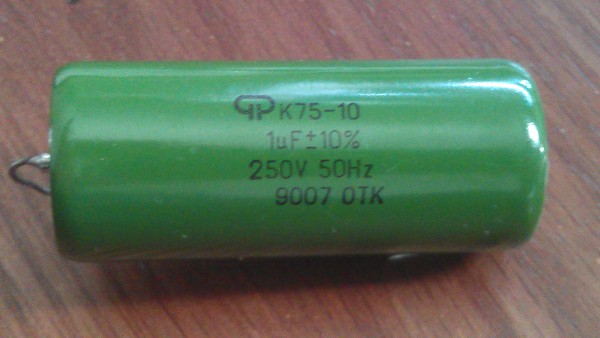

    Thay hai con tụ xuất mầu đen bằng 2 con K75-10 có lại không muốn tháo ra.
  10. tranchung159
    tranchung159 Advanced Member
    9/8/12
    612
    19
    Thêm cho anh em ít hàng ngon, bổ, rẻ, vừa đọc ít review của khoai tây.
    I honestly must agree with Jon L's review from August 22, 2009
    "On its own, K75-10 has an extremely plump, rich, midrange-centric sound with tons of (extra?) texture, very unique-sounding. It would be exactly the wrong choice for many push-pull tube amps.
    In single-digit watt single-ended amps with plenty of top-end, K75-10 can be very effective. In fact, bypassing it with a VCap teflon of about 1/10th the value can result in world-class sonics compared to the best IME.." Jon L
    that this cap is impressive. I realize many of you have found it lackluster and bad in many cases. From my experience this cap has one of the finest midrange characteristics of any cap I have tried and heard,this includes the following!
    1. Russian K40y-90
    2. Sprague Vitamin Q
    3. Mundorf Silver/Oil
    4. VCap TFTF
    5. Clarity Cap ESA
    6. Sonicap Gen I
    7. Obbligato Gold Premium
    8. Amp Ohm Tin Foil in Oil
    Now mind you I am not saying this is the best cap out there as we all know it does not exist, I am simply expressing an opinion that this cap has an incredible midband that has unbelievable grip and texture. It's upper register is definitely it's weak spot and bass is just okay. Caps listed above do a many great things and my favorite for midrange is AmpOhm but the K75-10 is excellent in mids where I bypass with a Russian Teflon at the moment and I'm going to try Russian Silver Mica soon!
    Thanks,
    Ramon

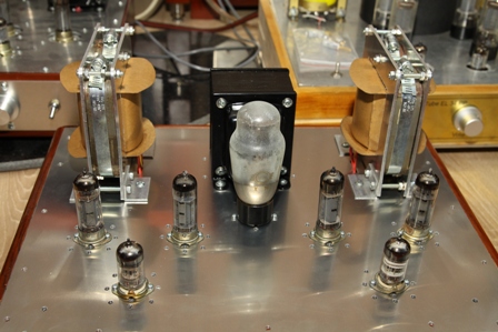

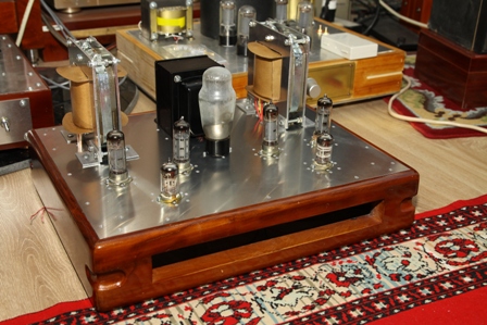

    Báo cáo CLB là dự án EL84 của em đã hoàn thành 3/4. Chậm tiến độ là do khách quan.
    Vài hình ảnh minh hoạ

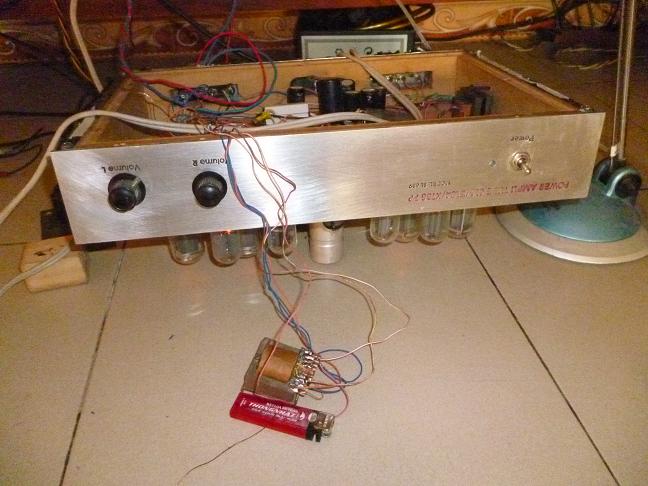

    Tin mới nhận:

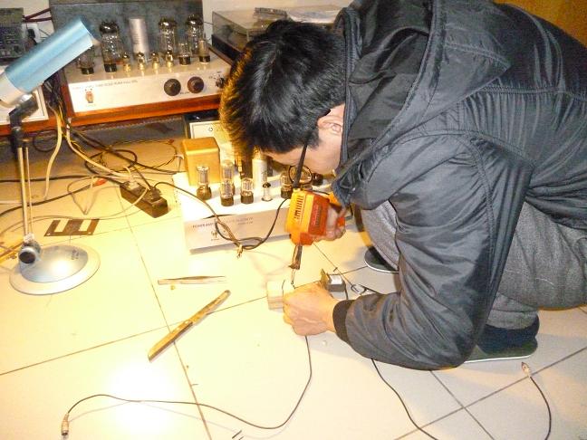

    Tối nay tôi và chú Đức cùng nhau thử quấn IT và mang ra nha mình thử.Kết quả hay hơn tụ khá rõ.Cuộn H cao dẽ mất dải cao thật
    Chú Đức đang chịu khó hàn xi đây ạ

    Tối nay một mình lại kỳ cạch thử tiếp

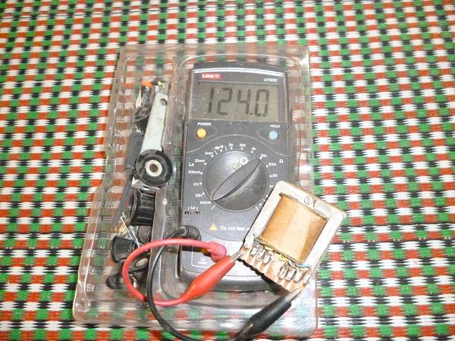

    Mình thiết kế Biến thế liên tầng có 4 cuộn đấu thành 2 cuộn có CT đo 1/2 cuộn 124H.2 cuộn quá thang đo chắc 480H.Liên tầng có tỷ lệ 1/1:1/1.Cùng cỡ dây.Fe niken cực tốt luôn.Âm ly của mình chạy 6H1 đấy kéo kiểu katot chung.Mình bỏ 2 điên trở gánh đấu 2 đâu của IT vào anot, đầu chung vào B+.2 đầu còn lại đấu 2 lưới đèn công xuất đầu giữa đấu vào G.
    XONG BẬT MÁY CHẠY
    tiêng nghe theo tai trâu của mình hơn nhiều ghép tu và gánh là điện trở,Mặc dù Henry rất cao nhưng mất dải cao là không rõ ràng khi nghe.
    Xong so với tải choke chấc hơn tý.Nhưng tai mình kém lắm.Nên phải nhờ mọi người vào nghe giúp.
    Bước tiếp theo mình sẽ quấn IT loại 3 cuộn.Đó là những tiến độ bước đấu trongvieecjj thiết kế choke tải và IT.Xin chia se cùng mọi người mong mọi người cho ý kiến ạ
    Con IT này fe Nikien rất tốt kích thước già nửa cái hộp quẹt nhưng Hen ri 500H mỗi vế

    Hen ry của em nó đây ạ thưa bác.Có 4 cuôn em đo 1 cuộn.Có fe tốt thì dùng fe tôt.nêu không thì phải dùng fe bự.gọi là lấy thịt đè người ý mà bác.Nhưng fe tốt vẫn hay hơn lý do nó it tổn hao,giảm được kích thước âm li
