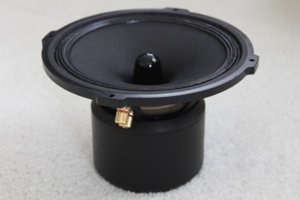

    "The Goshawk has landed..."
    Gioi thieu may bac, sau khi nghien cuu ky ve Field Coil, minh order mot vai mon de thu, tinh ra oder gan 3 thang, hang moi toi tan tay. Ly do ton nhieu thoi gian la vi chu nhan hang noi rang moi chiec Field Coil, ton cong mot ngay troi de lam. Sau 3 ngay va nhieu thi gio de thu, am thanh cua Field Coil nay da khong lam minh that vong (nguoc lai voi Feastrex, Lowther da lam cut hung rat nhieu khan gia khi nghe demo boi Nelson Pass). Nhin ve chat luong thi driver nay duoc lam rat ky, frame duoc cast rat day, dac biet nhat la cone va supension cua driver nay, nghe noi cone duoc lam bang cellulose (paper) va mot chat rat dac biet chua tung co driver nao tu xua toi bay gio dung den.

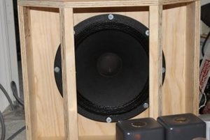

    15in Field coil trong thung dipole.

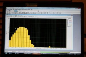

    Day la RTA cua Field Coil:

    8in Field Coil voi electromagnet co suc manh bang TAD 4001.

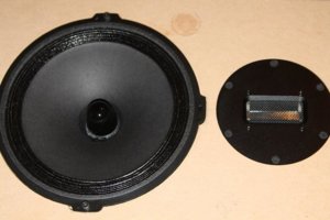

    Field coil 8in va ribbon thay the JBL 2441/077.

    Bộ này Anh dùng mấy cặp Ribbon vậy ??? 3 hay 4 cặp G2Si

    Cap ribbon ny nguoi ban order hoi dac biet . No giong G2SI (cung hang Aurum Cantus), nhung ribbon bang aluminum honeycomb , theo nguoi ban noi thi distortion thap hon (vi honeycomb cung chac hon, giong nhu Aerolam de lam cho san may bay), nhung vi ribbon nang hon nen do nhay thap hon vai db. Vi minh dung active nen chi can chinh ampli volume cao hon. Minh dung 4 cap, cai cuc den tren FC la ribbon thu 4 chia xeo len troi.
