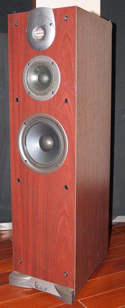

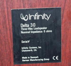

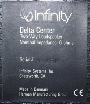

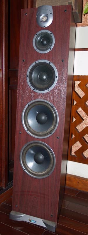

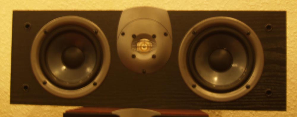

  12. mogia
    mogia Approved Member
    16/2/06
    34
    Hà nội
    Thung loa X way - Y speakers.
    Mogia tui xin loi nhe. May tinh bi loi font nen khong go duoc tieng Viet.
    Mo tui xin duoc post vai hinh anh minh hoa cho cai van de tren thung loa co ghi X way - Y speakers.
    Theo thien y Mo tui thi:
    - Y bieu thi cho so loa con duoc dat trong 1 thung, moi loa con nay thuong dam nhiem (cho hieu qua cao nhat ve am hoc) cho mot dai tan nhat dinh, co the co nhieu loa con giong nhau cung dam nhiem cho mot dai tan.
    - X bieu thi cho so duong tieng ma mach phan tan cho ra cac loa. Mot duong tieng co the cho 1 loa con rieng re hay nhieu loa con.
    Do la dieu tui nghi khong biet co dung hay khong, mong cac thay trong 4rum gop y cho.
    Kinh.
