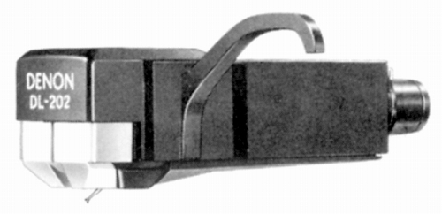

    Denon DL-202 MM Specs;
    ■Price 30,000 yen
    ■Generation method MM type
    ■Output voltage 2mV/1kHz 5cm/sec
    ■Stylus pressure 1.3-1.7g (optimal 1.5g)
    ■Reproduction frequency range 20-60,000Hz
    ■Channel separation 25dB or more/1kHz
    ■Channel balance 1dB
    ■ Compliance 13×10 -6 cm / dyne
    Load
    resistance approx
    . ■Discontinued 1985 ■Remarks The price is around 1979 Shell integrated type

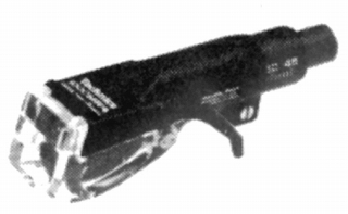

    Technics 100mk4
    ■Price 75,000 yen
    ■Output voltage 1.2mV (5cm/sec 1kHz horizontal peak)
    ■Stylus pressure 1.0-1.5g (optimal 1.25g)
    ■Playback frequency range 5-120,000Hz
    ■Channel separation 25dB (1kHz)
    ■ Channel Balance 0.5dB(1kHz)
    ■Compliance 12×10 -6 cm/dyne (Dynamic 100Hz)
    ■Load Resistance 10k~1MΩ (Parallel Capacitance 500pF)
    ■Load Capacitance
    ■Internal Impedance 210Ω(R・30Ω L・33mH)
    ■Stylus Tip Linear elliptical
    ■Weight 18.3g
    ■Interchangeable stylus EPS-100ED4
    ■Released November 1982 ■
    Discontinued around 1990-92 ■
    Remarks Price is for around 1982
    Headshell integrated
