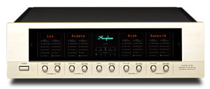

    Chào bác Trung. Em đây ạ!
    Xin phép bác cho em phát biểu nhé. :lol:
    Theo hiểu biết của em thì việc này giải quyết khá dễ dàng nếu dùng Frequency Dividing Network DF-45 bác ạ.
    "Frequency Dividing Network DF-45
    Multi-channel divider with fully digital signal processing - High-speed 40-bit floating point DSP provides the processing power for four channel units supplied in standard configuration. Choice of 59 cutoff frequency points ensures total flexibility. Highly accurate digital filters enable 96 dB/octave slope characteristics. Time alignment function adjustable in 1-cm steps, plus delay compensator for offsetting filter circuit delays ensure superb spatial accuracy. HS-Link capability provides SA-CD support.
    Channel divider units with high-speed DSP for fully digital signal processing
    Equipped for 4-channel (4-way) system configuration
    59 selectable cutoff frequency points
    Highly accurate 96 dB/oct attenuation slope
    Time alignment function allows delay time setting in 1-cm steps
    Delay compensator offsets signal delays in filter circuitry
    Further refined MDS++ D/A converter"
