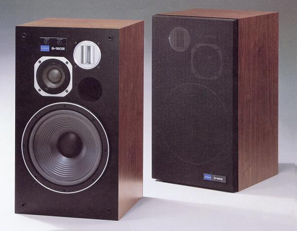

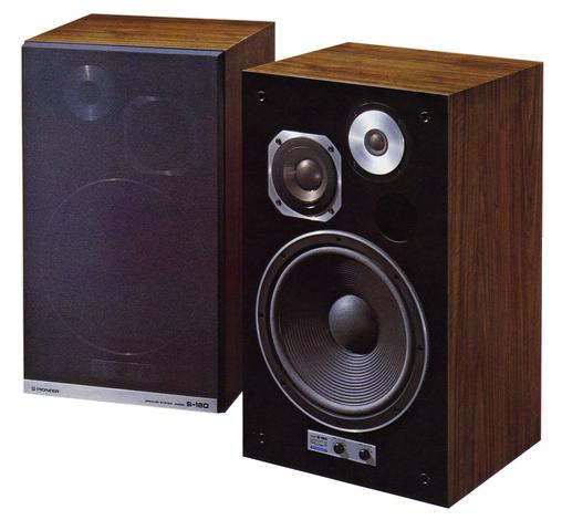

    Bác nào giải thích giùm em thông số kỹ thuật của 2 em này với. Trân trọng cảm ơn các bác.
    S 180
    System 3 ways 3 speakers [basurehu] system bookshelf type
    Use unit It is low the for limits: 32cm cone type
    For middle limits: 12cm balance drive type
    For high pass: 2.5cm dome type
    Impedance 6.3Ω
    Playback frequency zone 30Hz~30000Hz
    Output overpressure value 95dB/W/m
    Instantaneous installed capacity overpressure value 119dB/m
    Largest input 120W
    Instantaneous largest input 240W
    Crossover frequency 1000Hz and 5000Hz
    Enclosure content volume 66L
    External size Width 385× height 650× depth 377mm
    Weight 25kg
    S 180 III
    For high pass: Ribbon type
    Impedance 6.3Ω
    Playback frequency zone 30Hz~50000Hz
    Rated input 60W
    Instantaneous largest input 200W
    Crossover frequency 800Hz and 6000Hz
    External size Width 380× height 670× depth 376mm
    Weight 25kg
