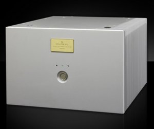

    Em cung cấp ít thông tin về Goldmund Telos 600 mà em tìm được trên mạng.
    Goldmund Telos 600
    SOLD $40,000.00 (PAIR)
    SEP 2010
    Mint Condition
    Original Shipping Box
    Worldwide Shipping
    2010 - R.R.P. US$51,500.00
    Mono Power Amplifier:
    Developed around the highly expected new JOB5 circuit developped by Goldmund during the last 3 years, the Telos 600 is the new flagship amplifier in the line of Goldmund “Ultimate” components. With a power of 600W before clipping on 8 Ohms the Telos 600 is able to drive any speaker to its limits. With around 3 MHz of bandwidth at full power, the Telos 600 circuit is also the fastest amp ever designed by Goldmund. As an extremely powerful amplifier may be dangerous if improperly used, Goldmund developped for the Telos family a new protection circuit of higher safety and without any signal influence.
    Special Features:
    Very high Fast Pulse Power before clipping : 600W/ch on 8 Ohms. This transient power is the best guarantee for hyper-realistic dynamic reproduction.
    Ultra-high speed new JOB5 circuitry : DC to 3 MHz bandwidth at full power before protection.
    Unique circuit time accuracy : better than 100ps. A unique figure in the industry. Time distortion remains the most detrimental type of distortion introduced by analogue electronics, because it represents a form of signal degradation not existing in real life. This figure is rarely published by high-end Audio manufacturers due to the poor results achieved by most today�s design.
    Unbalanced Analogue, Balanced Analogue, and Digital SPDIF inputs available. A 9-step input attenuator adjusts the level of the input by 3dB steps to match the volume in multi-channel systems.
    Digital input module based on the new Alize 5 circuitry developed for the Goldmund Eidos Reference, the most accurate D/A circuit ever designed by Goldmund.
    Mechanical Grounding construction for proper evacuation of any vibration-generated spurious signal inside the amplifier when played at high levels. New separate input and output circuitry to guarantee the mechanical Grounding of the Output circuit.
    Improved Thermal Grounding construction : The power output Mosfets are assembled on a new twice larger gold-plated pure copper heat-transmitter to achieve an ultra-fast heat transfer and so limit temperature-related dynamic losses. The isolators used are in specially-treated Kapton, the thinnest and best isolators providing the highest thermal transfer rate.
    Ultra-fast power supply design : 10 built-in high-speed transformers, separate ultra-fast rectifiers for each of the 2 supplies and multiple low capacitor values are used in the design in order to provide the fastest possible signal amplification without power-supply-induced contamination.
    In addition to the 2 x 5-way binding post speaker outputs, the Telos 600 provides 2 Direct Goldmund Speaker Cable connection. The Direct Goldmund Speaker Connection provides the best possible link with the Goldmund Speaker Cable, avoiding its amplifier adapter. The connectors used (1.5GHz bandwidth and 4.5kW power capability) provide a contact quality and a perfect impedance matching that no banana or lug connection, even of highest quality, could offer. When coupled with the Epilogue Goldmund speaker system, no speaker adapter is used either, again increasing speed and time-accuracy of the high-energy transfer.
    Totally new protection circuit giving much more resistance to the Telos 600 against mishandling. Output overload, temperature limitation, protection against HF and DC signals are all activated without any relay in the signal path.
    Signal Sensing auto power on with adjustable sequencer and soft start to avoid power surges in multi-amp systems. Ultra-safe operation controlled by a separate micro-processor for glitch avoidance.
    Specifications:
    Power
    Nominal continuous power : 350 W RMS (2 - 8 Ohms), 175 W RMS (1 - 16 Ohms).
    Maximum instantaneous power : 600 W (8 Ohms).
    Maximum voltage swing : 85 V peak.
    Maximum current swing : 35 A peak.
    Frequency Response
    These figures are valid for the amplifier circuit alone, loaded by 8 Ohms and working at any level between 0 and nominal power.
    +/- 0.1 dB, 0 - 300 kHz, +/- 1 dB, 0 - 1000 kHz. +/- 3 dB, 0 - 3 MHz.
    Input Sensitivity
    Nominal level : 1.45 V RMS.(Adjustable -9->+9dB)
    Voltage Gain : 28.2 (29dB).
    Input impedance : >50 kOhms.
    Group Delay
    Propagation delay < 100 ns stable with frequency from DC to 200 kHz.
    Distortion
    Figures valid for all levels from 0 to 40 V / 8 Ohms :
    Dynamic : TID < 0.01 % (- 80 dB) unweighted.
    Static : THD < 0.01 % (- 80 dB) unweighted.
    Circuit Speed
    Slew rate : > 400 V/us.
    Rise time : < 300 ns.
    Noise
    Signal-to noise ratio : > 115 dB.
    Weighted ASA A : > 130dBA.
    Operating Temperature
    Room temperature : -30 to +40 degrees Celsius (-22 to +104 degrees Fahrenheit).
    Internal temperature : +45 to +65 degrees Celsius (+113 to +149 degrees Fahrenheit).
    Power Supply
    Nominal line voltage : 117, 234 V (switchable).
    Input voltage range : +/- 10 %.
    Maximum power consumption : 2400 W.
    Power used in standby : 80 W.
    10 toroidal transformers
    6 separated power supplies
    Grounding
    Semi-floating chassis connected to mains earth.
    Safety Features
    AC voltage fuse : min 16 A slow-blow.
    Front Panel Controls
    2 Power keys
    Standby and Power leds.
    Digital Input Lock led.
    Over-Temperature led.
    Overload led.
    HF and DC protection led.
    Rear Panel Connectors And Controls
    Input attenuator : 7 x 3dB steps.
    Power cord: universal socket 3 lugs.
    Main fuse (16A slow-blow).
    Output speaker 2 X 5 way binding post in parallel.
    Output speaker 2 Coaxial Connectors in parallel.
    Analogue Input connector RCA.
    Analogue Input connector XLR for balanced input.
    Digital Input and output connectors RCA.
    Digital Channel selection switch.
    Digital / Analogue Input selection switch.
    Size And Weight
    Dimensions : 33 cm (13”) W x 47 cm (18.5”) D x 27 cm (10.5”) H.
    Weight : 51 kg net.
    Tổng thể về công suất thì lớn hơn V1 của em khoảng 3 lần.
    T600 dùng 24 mosfet chạy BTL,em chạy 8 mosfet/1 chanel.

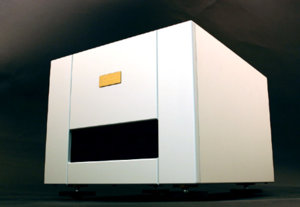

    Em vừa order 2 bộ vỏ như thế này để làm monoblock cho 1 bác ngoài HN.
    Đầu tháng em nhận được hàng về,em sẽ updat dự án này để các bác cùng test cấu hình monoblock BTL xem sao. :D
  24. HDhunter
    HDhunter Advanced Member
    13/1/10
    3.186
    Gầm cầu Long Biên
    Re: Ra mắt Gôn Mun Clone V1 tại Hà Nội (23-5-2011)
    Vậy mai ghé tôi làm tý đi :D Vỏ càng ngày càng to cụ Ultra nhỉ
