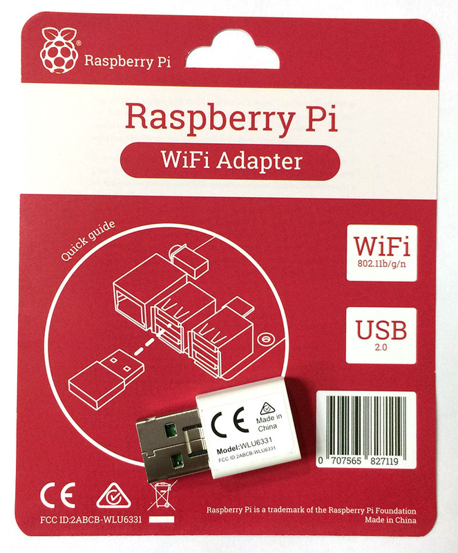

    Bác @tml3nr cho hỏi thăm đã dùng những usb wifi nào và độ ngon ra sao ah?

    Em thử được khoảng mười mấy cái usb wifi ạ. Cuối cùng em dùng AE làm client wifi thì thấy ít noise nhất.

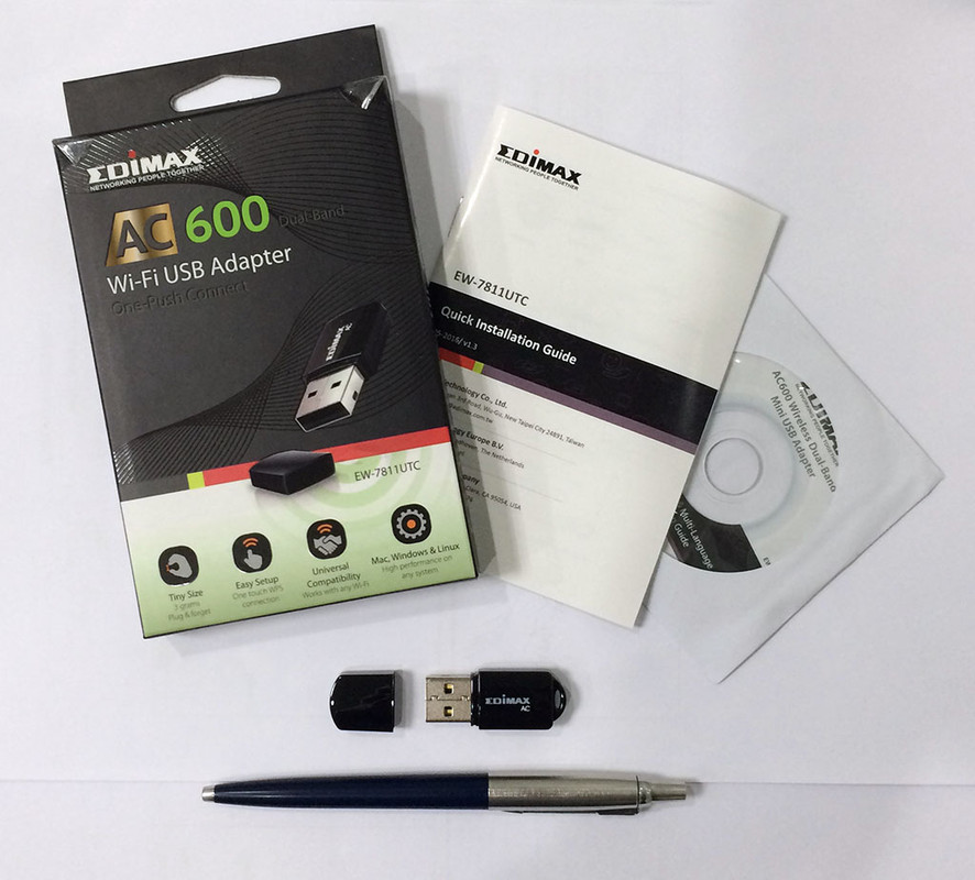

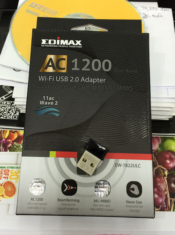

    Cảm ơn kinh nghiệm quý báu của bác! Sẽ thử con Edimax xem sao ;)

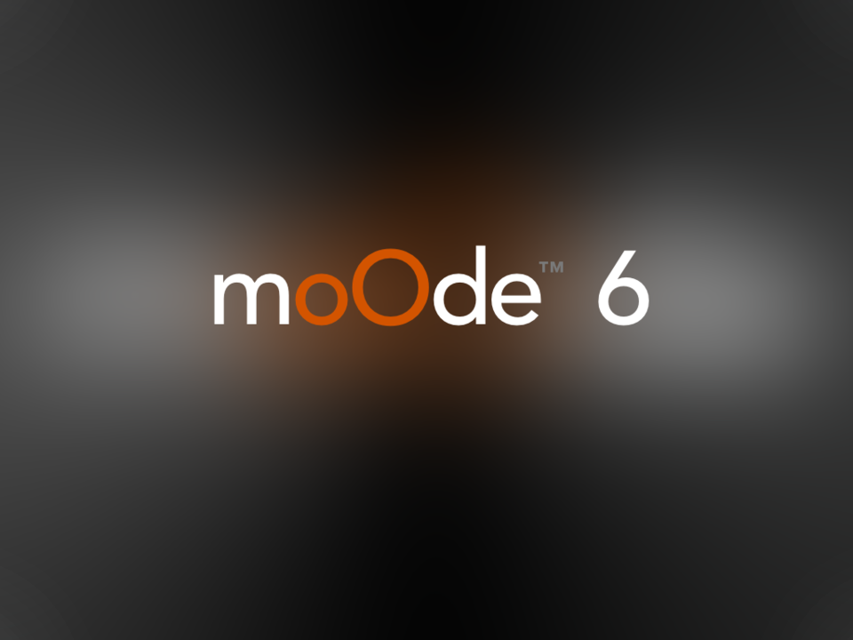

    Đã có moode 6.0 ạ!
    Relnotes:
    // 6.0.0 2019-08-08
    New features
    - NEW: Raspbian 10.0 (Buster Lite)
    - NEW: Support for Pi-4B 1/2/4GB models
    - NEW: UPnP Media Browser
    - NEW: Caching Library loader
    - NEW: Screen Reader accessibility
    Updates
    - UPD: Bump to Linux kernel 4.19.64
    - UPD: Bump to PHP 7.3.4
    - UPD: Bump to NGINX 1.14.2
    - UPD: Bump to SQLite 3.27.2
    - UPD: Bump to MiniDLNA 1.2.1
    - UPD: Bump to Shairport-sync 3.3.2
    - UPD: Bump to ALSA 1.1.8
    - UPD: Bump to Boost 1.68
    - UPD: Add MPD 0.21.13 for testing
    - UPD: Add haveged entropy generator
    - UPD: Add rev codes for Pi-4B 1/2/4GB models
    - UPD: Add clock radio "after stop" Actions
    - UPD: Add Spotify clear credential cache
    - UPD: Add Instant Play options: Add/Play, Clear/Play
    - UPD: Add Show Genres column (Yes/No) to Library options
    - UPD: Add buffertime param to BlueZ config
    - UPD: Remove restriction on quotes in Wifi password
    - UPD: Disable PHP session clean and timer
    - UPD: Improve Play/Playall response on slower Pi-Zero
    - UPD: Improve Audioinfo layout and content
    - UPD: Improve System info layout and content
    - UPD: Improve layout of config screens
    - UPD: Improve auto-config process
    - UPD: Improve in-place update process
    - UPD: Improve overall robustness and performance
    - UPD: SwissGroove radio url
    Security
    - UPD: Strengthen input arg parsing in command/index.ph
    - UPD: Remove script path input arg in lcdup.sh
    - UPD: Convert from plaintext WiFi passwords to PSK's
    Bug fixes
    - FIX: Lazyload not started after search in Album view
    - FIX: Missing href in Bluetooth Active overlay
    - FIX: Wrong default fill color for radio buttons
    - FIX: JSON parse errors being unnecessarily displayed

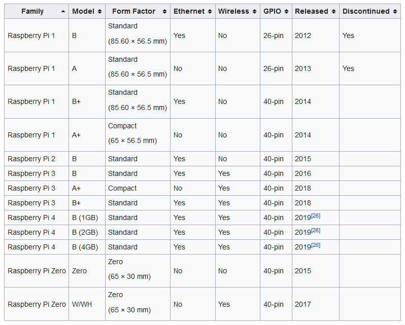

    - Anh khoan gắn dac, thử phát nhạc bằng cổng 3.5mm trên pi trước xem sao ạ? Nếu nó ok mình sẽ gắn dac vô sau. Lưu ý xem OS có support phiên bản pi của anh không?
    - Hỏi người bán xem chọn dac gì phù hợp với nó?
    - Thử lần lượt các dac dùng dac chip PCM5102. Nhớ reboot sau khi thay đổi.
    PS: Anh kiểm tra kỹ lại xem pi của anh là pi gì ạ?
    https://en.wikipedia.org/wiki/Raspberry_Pi

    Trong tg chờ dac về mình cũng đã thử tất cả các os và nghe tốt qua cổng 3.5. Gắn dac vào, rpi nhận dac lên đèn led màu xanh. chọn âm thanh i2s play vẫn phát nhưng ko nghe tiếng.
    tml3nr likes this.
  19. dung44
    dung44 New Member
    10/8/19
    Rpi mình là cái đầu tiên

    Từ Moode 5.3.1 bấm Check update không thấy cho lên Moode 6.0 :(
  22. chuvanvu
    chuvanvu Advanced Member
    12/1/17
    701
    606
    Phải flash thẻ nhớ từ đầu bác ạ. Nó cũng không có sao lưu cấu hình.
