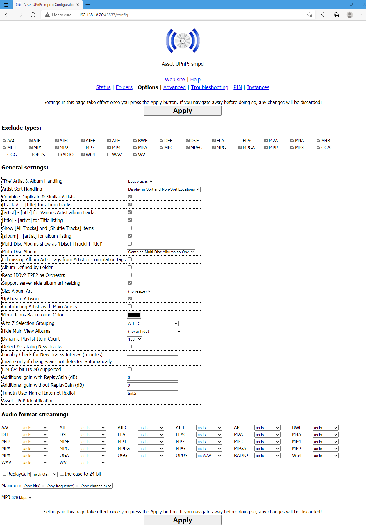

    # Để cài asset upnp, anh làm như sau ạ:
    Code:
    wget https://www.dbpoweramp.com/install/Asset-RaspberryPi.tar.gz
    tar -xzvf Asset-RaspberryPi.tar.gz
    cd Asset-R7.2-Linux-ARM32-trial
    chmod -R 777 ./INSTALL.sh
    ./INSTALL.sh
    Vậy là xong ạ.
    Nếu muốn chạy asset upnp bằng root (Tiếng hay hơn một chút). Anh edit crontab:
    Code:
    crontab -e
    Sửa lại nội dung như sau:
    Code:
    @reboot sudo /home/pi/bin/AssetUPnP
    Quản lý asset upnp bằng webui:
    http://x.x.x.x:45537/

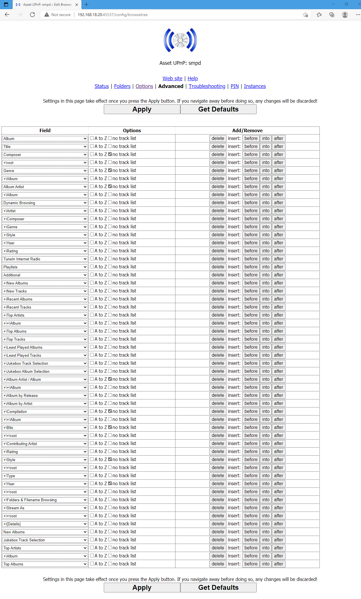

    Em set như sau thấy tạm ổn:
    Raw Browser Tree:
    Code:
    Album
    Title
    Composer{_no_track_list_}
    Composer\root
    Genre{_no_track_list_}
    Genre\Album
    Album Artist{_no_track_list_}
    Album Artist\Album
    Dynamic Browsing
    Dynamic Browsing\Artist
    Dynamic Browsing\Composer
    Dynamic Browsing\Genre
    Dynamic Browsing\Style
    Dynamic Browsing\Year
    Dynamic Browsing\Rating
    TuneIn Internet Radio
    Playlists
    Additional
    Additional\New Albums
    Additional\New Tracks
    Additional\Recent Albums
    Additional\Recent Tracks
    Additional\Top Artists
    Additional\Top Artists\Album
    Additional\Top Albums
    Additional\Top Tracks
    Additional\Least Played Albums
    Additional\Least Played Tracks
    Additional\Jukebox Track Selection
    Additional\Jukebox Album Selection
    Additional\Album Artist / Album{_no_track_list_}
    Additional\Album Artist / Album\Album
    Additional\Album by Release
    Additional\Album by Artist
    Additional\Compilation{_no_track_list_}
    Additional\Compilation\Album
    Additional\Bits{_no_track_list_}
    Additional\Bits\root
    Additional\Contributing Artist
    Additional\Rating
    Additional\Style{_no_track_list_}
    Additional\Style\root
    Additional\Type
    Additional\Year{_no_track_list_}
    Additional\Year\root
    Additional\Folders & Filename Browsing
    Additional\Stream As
    Additional\Stream As\root
    Additional\[Details]
    New Albums
    Top Artists
    Top Artists\Album
    Top Albums
