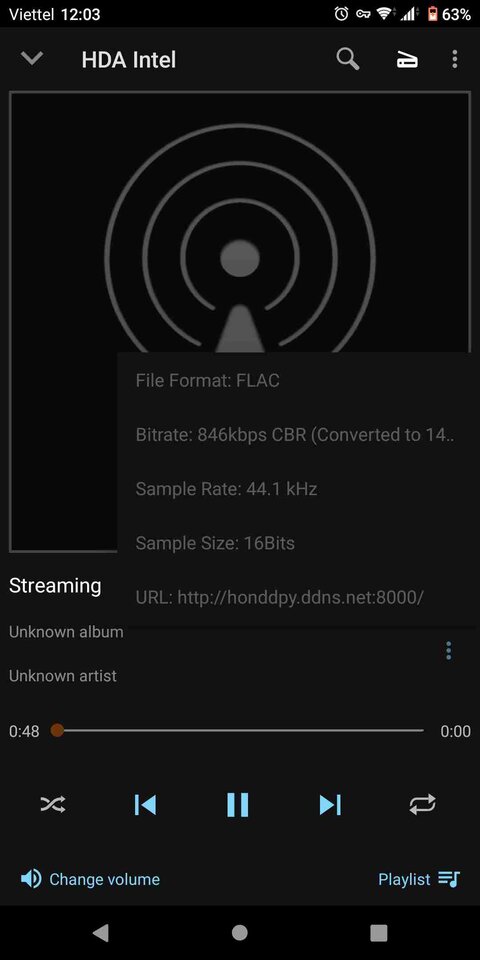

    Bác Hải sưu tầm phát ngoài quán tuyệt vời a . :cool:
    http://honddpy.ddns.net:8000/
    2ndFACE, tml3nr and TQ_Audio like this.
