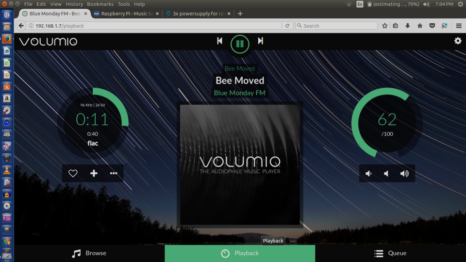

  12. Pilab
    Pilab Advanced Member
    29/1/09
    1.732
    329
    TP ThanhHoa, VietNam
    On
    File 24/96
    mlab and tml3nr like this.
