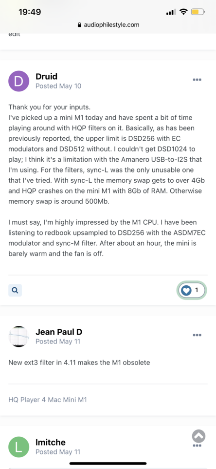

  23. thichPi
    thichPi Advanced Member
    16/3/21
    464
    572
    tieuphi2006 and anhton82 like this.

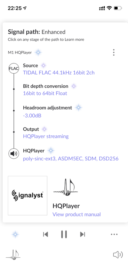

  24. anhton82
    anhton82 Advanced Member
    19/8/10
    734
    669
    tieuphi2006 likes this.
