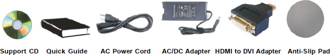

    Con này đã bán ở VN rồi các bác ơi
    asrock ION 330
    ■Intel®Atom™ 330 (Dual-Core CPU)
    ■NVIDIA®ION™ graphics processor
    ■Small (2.5L)
    ■Silent (acoustic below 26 dB)
    ■Stylish (High gloss outlook)
    ■Energy Star 5.0 level (Low power consumption)
    ■ASRock OC Tuner (Overclocking)
    ■ASRock Instant Boot
    Features
    Accessories
    Product Specifications
    Features
    Dual-Core Atom 330
    A nettop, based on the Intel®Atom™ processor, is a an innovative device offering basic PC functionality. These purpose-built devices deliver an affordable basic computing experience and easy access to the Internet.
    low power solution designed for:
    •Content consumption +light content creation
    •Easy access to the Internet
    •Basic computing +light multitaskingNVIDIA® ION™ graphics processor width Full HD 1080p
    ASRock ION 330 comes with the latest Atom™ + NVIDIA®ION™ graphics processor. It satisfies you with the high quality audio and visual environment. Comparing with other system conguration, ASRock ION 330 provides 10 times faster in speed for graphics and video encoding performance scaling. In addition, it also supports Full HD 1080p (Blu-ray /HD-DVD)*playback, 3D gaming, premium Windows®vista, and Windows®7.
    *Blu-ray/HD-DVD disc is supported by Blu-ray/HD-DVD drive.Small (save more space)
    Energy Star is an international standard for energy efficient consumer products. Devices carrying the Energy Star logo save 20%-30% on average.
    ASRock NetTop series Energy Star 5.0 Test Result:
    Model Name CPU Memory OS Supply Voltage
    115 Volts AC, 60 Hz 100 Volts AC, 50 Hz 230 Volts AC, 50 Hz
    ASRock ION 330 Atom 330 1G 800 x 2 XP 99.461TEC(KWh) 98.226TEC(KWh) 101.147TEC(KWh)
    ASRock NetTop series fully support Energy Star 5.0ASRock Instant Boot
    ASRock has overcome the technical obstacles and exclusively invented a new technology that allows you to turn on your PC in just a blink of an eye! Not only it saves energy, money, it also helps system running speed. This feature is applicable to both Windows®XP and Windows®Vista™!ASRock OC Tuner
    ASRock OC Tuner is a user-friendly ASRock overclocking tool which allows you to guard your system by hardware monitor function and overclock your hardware devices to get the best system performance.All Solid Capacitors Design
    Our long life solid capacitor is sourced form 100% Japan-made high-quality Conductive Polymer Capacitors.Dual-Channel Memory Design
    ASRock ION 330 comes with Dual-Channel memory, which is 2 times faster than the single channel memory. Comparing with other NetTop which supports only single channel memory, ASRock ION 330 with Dual Channel memory design can truly deliver the performance of Atom 330 dual-core CPU.ASRock Top Production & Quality Control
    - EMI Test
    - Vibration Test
    - Drop Test
    - Acoustic Test
    - Thermal Shock Test
    - Power Consumption Test
    - Power Line Disturbance Test
    Specifications
    CPU - Intel®Atom™ 330 (Dual-Core CPU)
    Chipset - NVIDIA®ION™ graphics processor
    Memory - 2GB DDR2 800 MHz memory, support dual channel, maximum memory capacity 4GB
    VGA - NVIDIA®ION™ graphics, support DX10 / Full HD 1080p (Blu-ray / HD-DVD)*playback
    HDD - 2.5” HDD 320GB
    DVD - DVD Super Multi (Slim type)
    I/O - 1 x HDMI (with HDMI to DVI adapter), 1 x D-Sub VGA, 6 x USB 2.0, 1 x S/PDIF (Optical)
    LAN - Gigabit LAN
    Sound - HD Audio 5.1 channel
    System Acoustic - Below 26dB
    Power Unit - 65W /19V Adapter
    Dimension - 195mm (W) x 70mm (H) x 186mm (L)
    Volume (liters) - 2.5L
    Weight - 1.69Kg
    Accessories
    Nơi bán: http://dichvuvienthong.com.vn/?u=cnt
