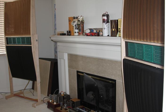

    Ton gan 1 nam de kiem linh kien de dung len mot cap loa hi-end ma dau tien minh duoc nghe tren dan HQD cua Mark Levinson nam 1978. Am thanh cap loa nay dung la vuot thoi gian, ra doi nam 1957, day la Stacked Quad ESL-57.

    Hon mot nam nay, khi bat dau topic, minh da thuc hien duoc loa Stacked Quad nhu tam hinh tren, kha cong phu la vi phai di kiem loa QUAD ESL 57 Electrostatic con trong tinh trang tot duoc san xuat tu nam 1957-1985. Ket qua la da kiem duoc 2 cap cach nhau 4 thang.
    Cap thu nhat mau Bronze duoc kiem ra tu mot nguoi o cho troi Electronic o De Anza College, cap nay nam o San Louis Obispo, nen phai chiu kho lai xe gan 400 miles 2 chieu de dem cap nay ve. Cap nay theo serial number thi biet duoc san xuat khoang nam 1960, nhung tinh trang rat tot phan Mylar con can thang va khong bi chay hoac lung lo.
    Cap thu 2 mau den duoc kiem tren Ebay, cap nay nam o Los Angeles nen nho mot nguoi ban toi coi. Sau khi duoc biet tinh trang tot, minh offer de Buy it Now va lai xe gan 700 miles de khien cap thu 2, tuy khong cung mau, nhung am thanh va tinh trang la quang trong nhat.
    De thuc hien mot cap loa hoan hao, am thanh phai duoc day du , nen Quad can phai nan cap cho hai yeu diem, do la phan bass va high.
    Ve phan bass thi da co san cap 15in Field Coil tren Open baffle , am thanh rat nhanh co le se phu hop voi dong loa Electrostatic hon nhung woofer khac.
    Ve phan high, sau khi thu qua vai linh kien nhu:
    - Ion plasma: Thiet ke thu mot Plasma tweeter dung tube 813, thi thay tweeter nay co 3 yeu diem: do nhay thap tuy nhien cung tam du, yeu diem thu hai la am thanh khong duoc rong khi nghe nhac ochestra, nghia la phai can 2-3 plasma tweeter moi dat duoc y thich, yeu diem thu 3 la Ozone, tweeter nay toat Ozone kha nhieu, chi sau 15 phut la can phong nho co mui hoa hoc, day la ly do chinh de bac bo plasma tweeter.
    - Ribbon: Am thanh ribbon cung kha, sau nay duoc san xuat ben Tau, chat luong cung kha tot.
    - Electrostatic: Mot bua nghien cuu nhung tweeter tren mang thi nho toi mot dong tweeter duoc lam boi Janszen, loai nay dau tien dung tren mot loa noi tieng thoi 1977 la Fulton Premiere. Phai noi bac Fulton la cha de cua speaker cable, san xuat loai day Fulton Gold, la soi day dau tien lon nhu Garden Hose (ong nuoc tuoi cay, khoang bang ngon tay cai). Duoc dip nghe Fulton Premier qua 2 ampli ARC D79B o Seminar cua tiem Garland Audio thoi do that la kinh nghiem hiem co. Loa nay dung khoang 12 mieng electrostatic tweeter cua Janszen. Mot loa bat chuoc Fulton Premier dung tweeter nay la Wilson WAMM. The la sau khi 4 thang tim kiem, cung vot duoc 24 mieng tweeter moi toanh cua mot nguoi ban tren Audiogon. Ket qua la tweeter Janszen coi nhu la phu hop nhat voi Quad vi cung la mot loai Electrostatic.
    Linh kien coi nhu da du, nhung dung len cap Quad voi tweeter cung khong phai la de, vi cap nay nang cung khoang 100 lbs, khoang 45kg. Ton them 4 thang troi nua, trai qua nhieu kho khan do toi , do lui, thi moi moan thanh duoc cap stand nhu tren hinh.
    Dan loa nay duoc power voi 6 ampli mono block.
    - Bass: 845 PP 50W
    - Mid: 845 SE 20W
    - Tweeter: 300B PSE 15W
    Cach day may thang, gap lai chu nhan truoc cua cap Quad Bronze (cung la mot tay audiophile voi nhieu do hiem, trong nha co dan loa rat hiem cua Lowther, va mot cap tuy hoi cu ky, nhung la , hehe Beveridge 5 ), moi bac ay toi nha de nghe lai cap loa Quad bac de lai, bac rat vui mung khi thuong thuc cap loa Stacked Quad rat ngac nhien vi am thanh ngoai suc tuong tuong. 6 thang sau cung gap bac nay o mot audio show nho o San Francisco, bac toi bat tay va noi mot cau "Am thanh dan Stacked Quad, lam man nhi cua toi rung dong toi bay gio chua het!"

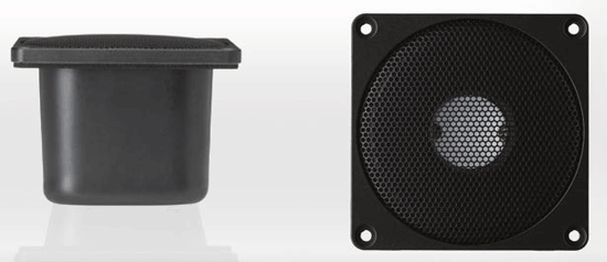

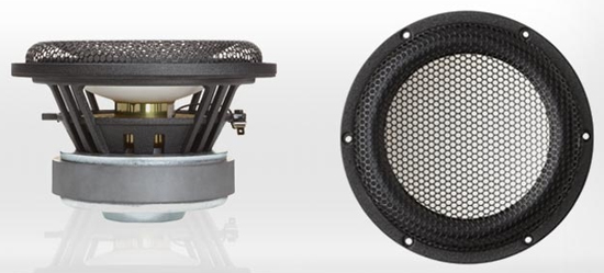

    Mot dong driver dang ke cho dan DIY la Accuton.
    Dung tren mot mini monitor voi am thanh xuat sac ma minh co dip thuong thuc o CES la loa Lìndermann. Ngoai ra Accuton con duoc dung tren rat nhieu loa noi tieng nhu Avalon, Kharma...
    Driver Accuton co mot yeu diem: Do nhay 88-90db.
