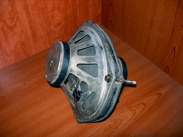

    nhân tiện , các bác cho em hỏi nên làm gì với hai em này:
    [​IMG][​IMG][​IMG]
    A pair of very rare early Siemens 6 Ruf lsp 14g fullrange speakers, made in 1948, featuring large CKS(Magnetfabrik Bonn) AlNiCo magnets. Diameter 8", VERY efficient (97db+ 1W/1m) with surprisingly extended frequncy response(16kHz), thanks to the ultra light paper cones. Adjustable phenolic spiders, wires stitched to the cones(!), DCR measures 12,2 Ohms and 12,4 Ohms, so the impedance ought to be rated as 15Ohms. Fres ~ 75Hz. Super fast impulse response.
    The paper surrounds are fine, Baskets with signs of age, the welded plates attached once held output transformers(no longer in existence), that's why there are no conventional wire terminals
    This is a very the fast and resolving fullrange speakers . Perfect for open baffle(with bass support from 100-150Hz up). Great match for PX25, AD1, RE604, 2A3 or even 45 SET amps. Use a 0,8 -1mH inductor(air core) to roll off the speakers at 6-7kHz if you want to add a tweeter.
    em mới tậu được , chưa biết làm gì với các em nó cả, cũng chưa biết tậu amp gì để phối với các em nó đây.
    mong các bác chỉ giáo cho
