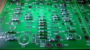

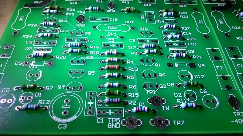

    Em cả biết up file cụ dùng tạm nha hồi chiều thấy cụ ôm lắm pcb thế cố gắng bơi lẹ nha :D :D
    R1 22k 2
    R2 47k 2
    R3,R4,R5,R6 33r 8
    R7,R8 620r 4
    R9,R10,R11,R12,R18 4k7 10
    R13 33K 2
    R14 5k1 2
    R15,R28,R29 100r 6
    R16.R17 1k5 4
    R19 3k3 2
    R20.R21 10k 4
    R22,R23,R24,R25 470r 8
    R26,R27 1k 4
    R30,R31 0.22 5W 4
    R32 10r 2W 2
    VR1 1K 2
    C
    c1 10p 2
    c2 22p 2
    C5 C6 C11 C12 22uf/50v 8
    C7 C8 100p 4
    C13 C14 220p 4
    C9 C10 C15 100nf MKT 6
    C3 1000uf/25v 2
    C4 470nf MKT 2
    Q
    Q1,Q2,Q5 BC560c 6
    Q3 Q4 Q6 BC550c 6
    Q9 Q14 ZTX753 MPSA56 BC640 4
    Q10 Q13 ZTX653 MPSA06 BC639 4
    Q15 MJE15031 2SA1837 A1930 2
    Q16 MJE15030 2SC4793 C5171 2
    Q17 2SA1216 2
    Q18 2SC2922 2
    Q7 Q11 Q12 BD139 6
    Q8 BD140 2
    D
    D3 D4 ZENER 24V/1W 1N4749a 4
    D1 D2 LED AMBER 4
    F
    F1, F2 10A 5A for test
