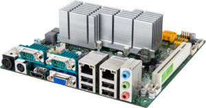

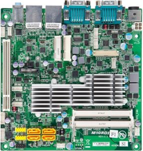

    Mainboard đây các bác nhé
    • Mini-ITX form factor
    • Intel® Atom™ D2550 1.86GHz processor
    • 2 x SO-DIMM, up to 4GB 1066MHz
    • 2 x GbE LAN ports (Realtek® RTL8111E)
    • 6 x COM ports (2 x external, 4 x internal)
    • 4 x SATA II 3Gb/s ports
    • RAID support

    Phụ cụ Syen một tay :
    Thông số đầy đủ của main
    • Form Factor
      Mini-ITX
      170W x 170D (mm)
    • Operating Properties
      Operating temperature: -10°C to 60°C
      Operating humidity: 0-85% (non-condensing)
      ŠNon-operating temperature: -40°C to 70°C
      Non-operating humidity: 0%-85% (non-condensing)
    • CPU
      Intel® Atom™ D2550
      2 cores / 4 threads
      1.86 GHz
      10W max. TDP
    • Socket
      1 x BGA 559
    • Chipset
      Intel® ICH10R
    • Memory
      2 x SO-DIMM DDR3 slots
      Single channel memory architecture
      Up to 4GB
      1.5V modules: 1066 MHz
    • LAN
    • Video
      Intel® GMA3650
    • Audio
      Realtek® ALC269 controller
      Supports 2/4 channel configurations
    • SATA
    • RAID
      Intel® SATA RAID 0/1/10/5
    • Expansion Slots
      1 x Full-size Mini-PCIe slot
      1 x Half-size Mini-PCIe slot
      1 x PCI
    • Internal I/O
      2 x USB 2.0 headers
      4 x Serial headers
      1 x Front audio header
      1 x Speaker header
      1 x System fan header
      1 x Front panel header
      1 x 4-pin 12V ATX power connector
      1 x LPC
      1 x GPIO
    • Rear I/O
      4 x USB 2.0
      1 x PS/2
      1 x HDMI
      2 x Serial
      1 x VGA
      1 x MIC-In
      1 x Line-Out
      1 x Line-In
      2 x RJ45
      1 x DC-In
    • TPM
    • OS Supported
      Windows 7 (32/64bit)
    • PSU Connectors
    • Power Supply
      1 x DC-In 12V/19V
    • Packaging Content
      1 x I/O shield
      1 x Serial cable (260mm)
      1 x SATA II 3Gb/s cable (500mm)
      1 x SATA power cable (100mm)
    syen+ likes this.
