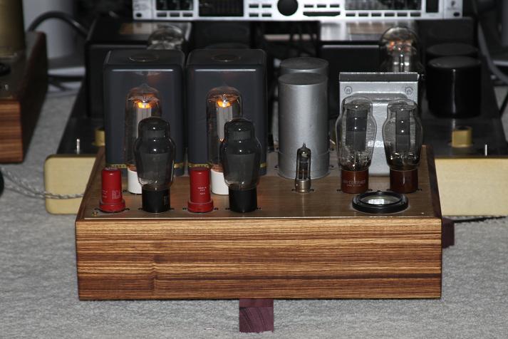

    Plate ma doi mau cam nhu vay, choi 8 tieng mot ngay chac la song khong nao lau dau bac, uong cap tube SV572. Bac dung transfo tu quan? Bac dung 5K?
    DUoi day la hinh ampli SV572 xai duoc hon 10nam , bay gio dung de chay ribbon.
