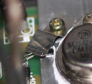

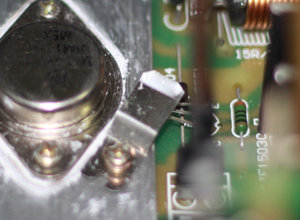

    Bù nhiệt cho 2N5551

    Mặc dù hầu như các cụ đã về đích hết nhưng em có cái lưu ý này để các cụ tránh hiện tượng sò nóng, lưu ý vấn đề sò nóng mới hay. Bởi Naim phải lạnh, lạnh tanh như ........... gái 18 :lol: :lol:
    Make sure no input nor speakers are connected to the poweramp.
    Les W recommends the bias current should be set by adjusting the resistor pot (VR1) such that the current measured going through the positive rail is set at 36-38ma. This should be done over about 20 minutes to ensure it does not change as the amp warms up and stabilises. DO NOT EXCEED 40 ma. This current is measured by measuring the current going through a milliameter from the powersupply rail to point A in fig1.
    An alternative method: Neil mcbride says "To set the biasing of the amp, do this: initially before you power-up for the first time, set the 2K trimmer [VR1] on the amp board to about the mid point. When the whole thing is up and running, you want to set the bias by measuring the voltage across [R12 in fig1] (the 0R22 resistor that is attached to the 'positive side' [of the] output device emitter). With no input, twiddle the trimmer until you get about at least 2.2 mV (ie, 10 mA bias current). The desired setting is arguable. I find about 20mA (4.4 mV) is about adequate, although I tend to run at 30 mA to be sure. Naim also use about 30 mA with their devices. There's room for experimentation. If you go too high the amps risk thermal runaway, but if heatsinking is adequate then 30 mA is worth using."
    Have a look at this page about bias and distortion, measured on a Nait 2. The same principles apply to all Naim power amps. Undoubtedly the correct way to do it is to set bias for minimum distortion, but you really need a scope amonst other equipment to do this. Fortunately the exact setting is pretty forgiving in the NAP design.
    Personally on my amp I solder a 10 ohm power resistor between the +ve psu supply and the +ve power terminal of the amp board. its just a bit of extra insurance. Aim for about 0.36V accross this resistor. When I'm there, desolder the resistor and resolder the supply direct to the amp board.

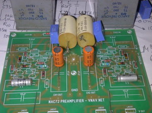

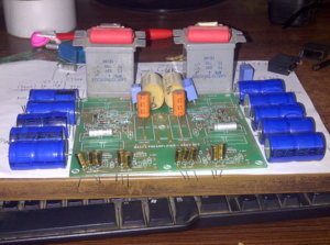

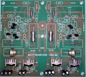

    Cái Nac72 của em mới dựng đến đây,em cần cặp tụ 10uF nữa là xong.Hôm trước có nhiều tụ ICEL 10uf tốt quá chừng mà mấy bác ác quá lặt sạch sẽ ,giờ cần tìm chả thấy.Xong cái này nữa là em có 7 cái pre luôn đó.Hôm nào cho chúng nó thi đấu 1 bữa...
    Linh kiện của em thế này không thể nói làm mà không hay được,em sẽ đưa cặp bjt Philips BC108B-BC178B huyền thoại vào đây là hết thuốc...
    Đang tính xin thuốc độc từ bác Tuninh Naichuoi va Thuanblack. :D

  7. GMR
    GMR Advanced Member
    9/9/09
    359
    nếu anh không chê bai em cho nhỏ 10uF - tantalum sang hầu hạ anh

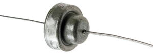

    em mua tantalum K52 của Nga hàng mới, 90V AC nên không cháy nổi đâu, đắt khét nên chỉ dám mua 4 cái, tiếng thì chẳng biết thế nào vì mới hàn được 1/2 vẫn còn thiếu nhiều

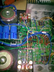

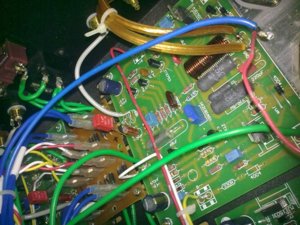

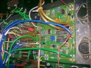

    Nhờ sự giúp đỡ tận tình của đại hiệp LongPCB Naim của em chính thức cất tiếng sau 1 năm chờ đợi. Post vài tấm hình khoe các cụ chơi.
