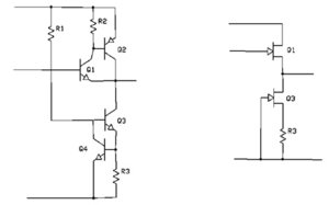

    "On the first thread I suggested to replace the NPN transistor with a jfet as a drop-in replacement in Naim preamp buffer stages. I reported good results so did others and some complained it wasn't so good. After using it for about a year I must say I agree. You gain something and you lose something. There was also a comment made by Hartmut that jfets need more bias to work properly, which is absolutely correct. I didn't give up and here is where I got, with excellent results.
    The circuit on the left is the circuit used on the Naim buffer stage and crossovers. A slightly simplified version without the PNP transistor is used at the output of the gain stage and the output of the phono stage. The circuit on the right is a well known and commonly used all jfet buffer stage which performs IMO much better.
    Both circuits work the same way: an emitter/source follower, and a current source. The circuit has a gain of one and is used as a buffer.
    The good news is that it is easy to convert the circuit on the left to the circuit on the right on the Naim PCBs without modifications to the PCB. Here is the trick:
    1. Remove R1, Q2, and Q4
    2. Replace Q1 and Q3 with jfets (I've used SK170BL and SK363GR accordingly)
    3. Replace R2 with a wire link
    4. Connect a wire link between the emitter and collector of what used to be Q4
    5. Replace R3 with 27R (for the above jfet transistors)
    This is it!
    For the gain and phono stage output, it's even simpler...
    Results are very good, far better than the modification on the first thread, and far better than the Naim circuit. IMHO"
    Đoạn trên trích dẫn từ nguồn diy của tây lông, em đọc mãi ko hiểu sao nó ko dùng luôn 1 cặp K170 đầu vào mà phải dùng kèm K363.
    Hình như bác lynhan159 có đi tiên phong vụ này rồi thì phải, chắc em cũng ướm thử xem sao. Thanks.

    Nếu không quan tâm đến những biểu thức toán học phức tạp thì nôm na có thể giải thích như ri:
    Cái mạch dùng nguồn dòng bằng JFET thì cơ bản con jfet đó phải có:
    1/high transconductance nhằm giảm trở kháng đầu ra nhỏ nhất có thể
    2 high Idss để tuyến tính tốt hơn và nâng khả năng gánh tải
    Con K363 chuyên làm nhiệm vụ này nhưng nghe ra hơi khó à.

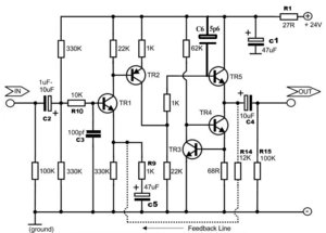

    chơi luôn đi anh! em chuẩn bị chỉnh cái IV theo ri :mrgreen: : đây là hướng dẫn gốc theo link sau
    http://www.pinkfishmedia.net/forum/showthread.php?t=54370

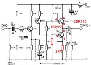

    Trên bo Naim Pre làm như sau:
    1. Tháo bỏ TR3, trở 62K, tụ C6 5p6
    2. Thay thế TR5 bằng SK170BL và TR4 bằng SK363GR
    3. Thay thế trở 68R bằng trở 27R
    4. Lấy mẩu dây nối chân C với E của TR3

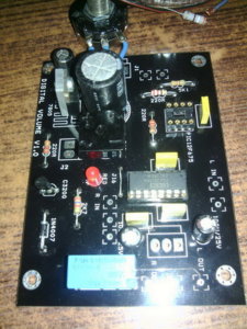

    Saigon mấy hôm nay chắc nóng nhất trong lịch sử,chả làm được con khỉ gì...Con pre PGA2310 hàn tới đây rồi mà phải bỏ,chạy trốn cái nóng thôi...
