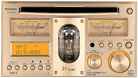

    Tây nó làm rồi !
    Panasonic CQ-TX5500D Vacuum Tube Car Stereo
    The Panasonic CQ-TX5500D ($950) is the only car stereo that we know of that features a built-in vacuum tube amplifier for all the retro-sounding overtones you so desperately desire. It plays CD, CD-R, CD-RW and MP3 discs, and emits an orange glow that you can see through the middle window when you're rocking out. The double-din stereo, which will fit in many import cars (and get rid of that stupid empty pocket thing in your dash at the same time), also sports old school meters that have needles instead of LEDs.
