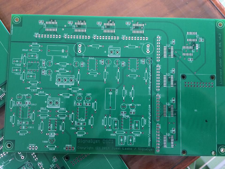

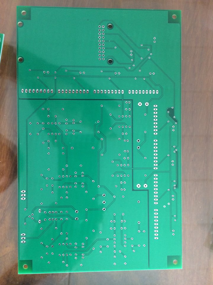

  19. giaothu
    giaothu Advanced Member
    19/7/11
    584
    113
    Board DSD ddddddddd aaaaaaaaaaa yyyyyyyyyyyyy
    DJVDK, luamiennam, cdhanh and 3 others like this.

  21. giaothu
    19/7/11
    584
    113
    Vẫn là thử nghiệm thôi em.

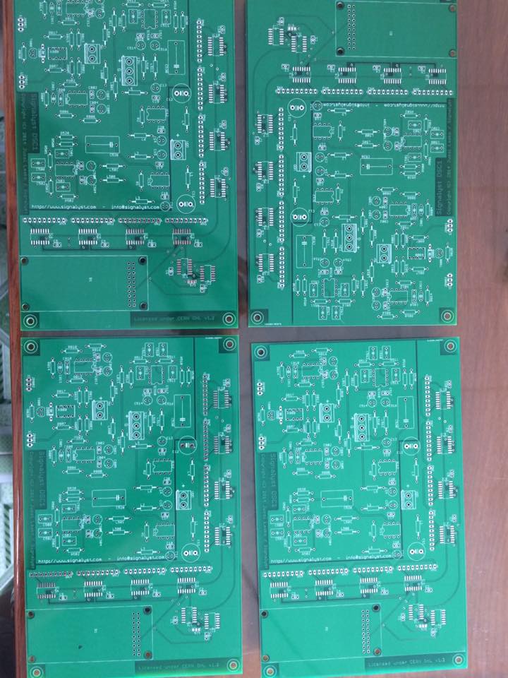

  24. giaothu
    19/7/11
    584
    113
    cdhanh and luamiennam like this.
