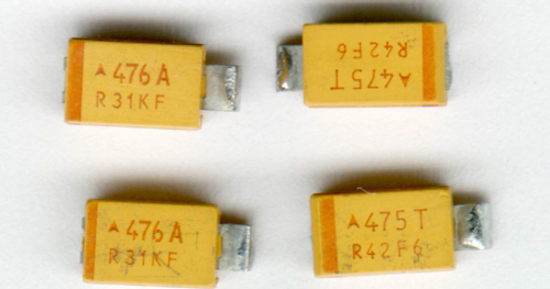

    Mot loai Tantalum cap bi lam gia, duoc kham pha vi date code tren con cap khong dung, hang Víhay khong san xuat cap nay o date code tren con cap, vi do la ngay le!

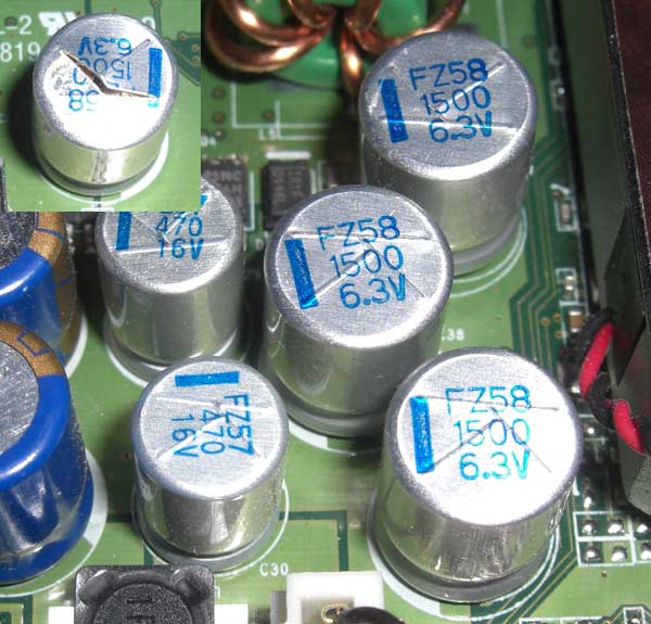

    Cap gia duoc kham pha tren Dell COmputer, con cap phong len, ly do la voltage rating qua thap:

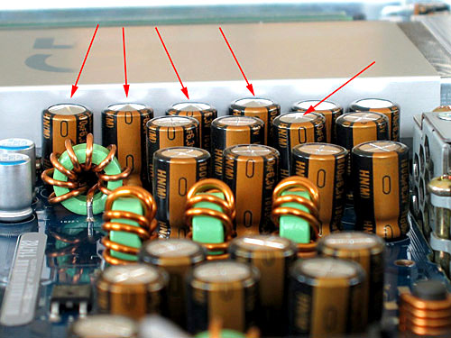

    Cap gia sap bi no, tui Tau thong thuong hay gia loai Rubicon, Elna, Sanyo vi nhng loai cap nay rat thong dung tren thi truong:
