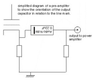

    Sao cái hãng này lại vẽ như vầy? :
    http://www.audionote.co.uk/comp/cap_paper.shtml

    Audio Note™ Signal Capacitors
    Directionality
    As you can see from the above picture each of our signal capacitors are marked with a line on the right, this marks the start of the foil. It is my experience that the Audio Note™ sound the best when the start of the foil is “facing” the incoming signal, see the drawing below.

    Dạ không, cách đấu khác nhau. Theo em bác làm theo khuyến cáo của Audio Note. Em nghĩ bác đã làm đúng (bác xem hình MrDuong đã đưa).
    “As you can see from the above picture each of our signal capacitors are marked with a line on the right, this marks the start of the foil. It is my experience that the Audio Note™ sound the best when the start of the foil (outer foil) is “facing” the incoming signal”.
    “ For coupling applications, orient the capacitor so that the outer foil connects to the "incoming signal" and the inner foil to the "output" side of the circuit. Signal sources are almost always lower impedance than signal loads.”
    Hai ý kiến trên giống nhau. Thân ái.

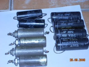

    BS Có mấy cái .47 mèo đen oách wá nhỉ?
