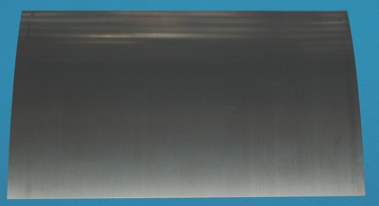

    Cảm ơn các bác đả động viên mình cũng muốn bỏ cuộc rồi nhưng hôm nay tìm được chổ mua đồ thay plate Nickel Sheet, .002" (.05mm), 6x4"
    $17.22
    One strip of pure nickel foil, cold-rolled and annealed.
    Sheets are available in sizes up to 6" x 50". We can provide custom cuts (rectangles, discs or other shapes) in small or large quantities economically. We can also provide custom machined, formed or welded nickel items (please inquire).
    Material: Nickel 200 or 201
    Thickness: .002" ±.0003 (.05mm ±.008)
    Dimensions: 6x4" ±.005 (152x101mm ±.13)
    Temper: Annealed
    Finish: Bright
    Hardness: Rockwell B50
    Meets: ASTM B162
    Chemical Composition:
    Ni
    99% C
    .15%(200)
    .02%(201) Mn
    .35% Cu
    .25%
    S
    .01% Si
    .35% Fe
    .4
    cung rẻ phải không may bác

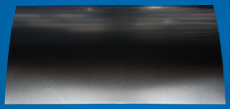

    còn đây là titanium loại này giá cao hơn nhung o biết âm thanh có tốt hơn o .càng đi sâu thì càng thấy mình xxx quá các bác ơi
    Titanium Sheet, .006" (.15mm), 6x4"
    $35.54
    One strip of Grade 2 titanium, cold-rolled and annealed.
    Sheets are available in sizes up to 12" x 50". We can provide custom cuts (rectangles, discs or other shapes) in small or large quantities economically. We can also provide custom machined, formed or welded titanium items (please inquire).
    Material: Titanium 99.2% (Grade 2)
    Thickness: .006" ±.0003 (.15mm ±.008)
    Dimensions: 6x4" ±.02 (152x101mm ±.51)
    Net Weight: 10.4g (±.1)
    Temper: Annealed
    Finish: Bright
    Tensile Strength: 344 MPa
    Modulus of Elasticity: 105 GPa
    Electrical Resistivity: 5.2e-005 Ω-cm
    Hardness: Rockwell B80
    Melting Point: 1665°C
    Meets: ASTM Grade 2
    Ti
    99.2% C
    .01% Fe
    .3% H
    .015% N
    .03% O
    .25%
