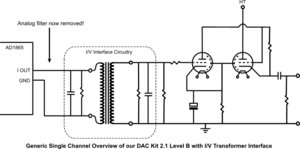

  20. trinhngoc293
    trinhngoc293 Advanced Member
    23/11/08
    5.838
    26
    Xã đoàn Gầm Cầu
    Re: The best DAC AD1865 đã có AD1865 xin cho Địa chỉ gấp
    Các cụ chiêng gia về ÀD1865 nhìn cái hình này có thể phán cho em cái điền trở và trị số tụ sát con transformer có nhiệm vụ gì và giá trị phù hợp thế nào được không ah? Cụ thể là với trở I/V giá trị 200Ohm, thì giá trị điển trở ở đầu xuất sẽ là bao nhiêu thì phù hợp ah?
    Kính mong các cụ quan tâm chỉ điểm. Có cụ nào giỏi cả lý thuyết cả tiếng anh dịch giúp em cho dễ hiểu với :oops:
    The explanation is simple. As there is no such thing as an "I/V" transformer there is nothing to discuss. The use of a transformer to match impedances os well known and documented. If you use a transformer with a stepup you trade Voltage Gain for Current Loss.
    If we took (for arguments sake) a PCM1704 DAC and a Transformer with a 1:10 ratio and a nominal (load) impedance of 25k we find that the +/-1.2mA current send into the transformer primary become +/- 0.12mA in the secondary. A 23k5 Resistor will convert this current to +/-2.8282V (2V rms). The output impedance of the Circuit will be in effect that of the I/V resistor, so 23k5. A last check, the load on the DAC is appx. 1/100 of the Secondary load, so the load seen by the DAC output is around 235 Ohm and the Voltage on the DAC output is around +/-0.283V.
    Absolute standard.
    Now an output impedance of 23k5 Ohm is rather unpractical in most systems and cannot tolerate long interconnects, that is the price you pay for being passive and simple. I would hence think that the Transformer and I/V Resistor should be mounted inside the Preamp/Amplifier to avoid exposing the output of the transformer to undue loads. The input impedance of the Pre/Amplifier needs to be accounted for in the 23k5 Resistance as well. This suggests a fully dedicated connection between CDP/DAC and Amplifier with a dedicated input and a dedicated defined interface that makes sure for the system to be completely incompatible with other equipment.
    Another option would be to follow our 1:10 Transformer with a Gainstage and place an added resistor in the primary to reduce the Voltage on the DAC's output and subsequently the transformer secondary. An ECC88 SRPP (lower cathode resistor unbypassed) has a gain of around 16 (24db). If we place a resistor of around 16R on the 1:10 transformers primary we will have an effective load on the DAC of around 15R, giving +/-18mV on the transformer primary and +/-180mV on the transformer secondary. After being amplified 16 Times by our ECC88 SRPP gives us a Voltage of +/-2.88V on the output, in essence the common 2V RMS.
    As can be seen, all this is the most basic and simple transformer behaviou, calling it EE101 is really stretching it, probably around 8th grader physics....

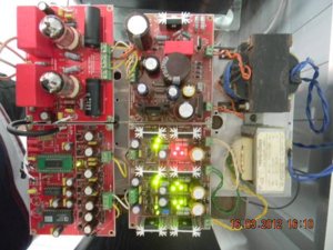

  24. tuanhaitin
    tuanhaitin Advanced Member
    18/4/10
    1.587
    16
    Phú Nhuận-HCM
    - Báo cáo DAC , VV cục biến áp C-core cho DAC. Em làm được tới đây.
    đang trong giai đoạn đấu dây. Quấn thì rất nhanh, khi ra dây thì em ngao ngán vì sáu cuộn 9VAC, thì ta có 12 đầu dây ra cho mỗi chữ C. 2 phần C-core nên ra dây hết thảy là 24 đầu dây, hoa cả mắt.
    Em hồi hộp đấu cuộn sơ trước coi nó còn r u n g r u n g không? Tuyệt nhiên không còn rung nữa, hết hoàn toàn. Cảm ơn Bác anhlongtranlf đã hỗ trợ.
    - Báo cáo hết. Cảm ơn Các Bác.

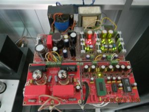

  25. nguyensyanhduy
    5/10/09
    920
    47
    BH-ĐN
    đây là em dac em mới hoàn thành xin các bác cho ý kiến mod phần nào ạ em chạy đèn 6h1 em muốn chạy opam thì phải làm sao ạ thanks
